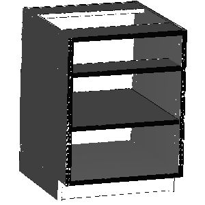

Hi Dale, I have entire librarys built this way. It would be nice to have it as a joint choice in the software. The way I typically do it now is to build the seed cabinet and take them into part editor and get my pilot holes on the ends, and then build everything off that seed for that library. I suppose you know you can then constrain these pilot holes and change widths/heights without losing you pilot holes.
seed.hsf
(760.02 KiB) Downloaded 506 times
