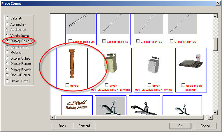

Do you see in your post how you put a red circle around the fluted column, well when I do that at my end all I see is a white or black square with the name. But when I select it to use in a drawing it shows up.
Re: Why my jpeg won't work
So, the only place you don't see the image is in the selection dialog?
