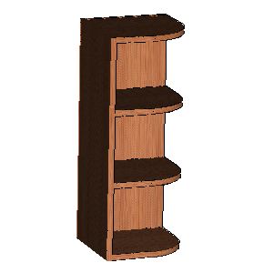

I don't know where to start in trying to build an end shelf. This is a shelf that is going to be placed at the end of run of wall cabinets and is rounded over. I don't know what to call these, I've just called them corner shelves but that is probably not the correct name. Basically, a 90 degree that hits the wall cabinet and the wall with the shelves rounded away from the cabinet. Can anyone help me? Sorry if I can't describe this that well.
Re: Corner Shelf
Hey Don, I took a seed upper cab and added two fixed shelves, then removed the right end, then hilited one shelf at a time and took them to the Part Editor. I then used the Fillet Tool set at 6" radius to cut the corner off each shelf.
