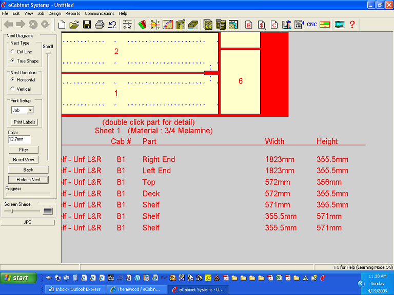

This is what I end up when I nest that cabinet. The top and deck should be the same, both are edgebanded on the front edge only (.5mm EB).

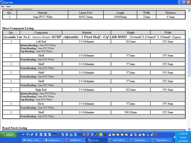

Or the cutlist, which doesn't seem to include the top, and is showing, what I'm guessing is the middle (fixed) shelf as 568.82mm H instead of 572mm.
I've read of the issue of the RTA fittings (some show up as red, some blue). I'm guessing its may be causing the other issues?

Corrected the length of the fixed shelf - values for left and right inset weren't set at 0. (Sorry on that, I'm new to the program.
The top still isn't showing up on the cut list...
