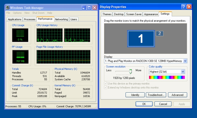

XP media edition,
Re: Freezing/crashing
Justin,
I would add more system ram. XP can eat up 1 gig and I think Dean told me eCabinets can use 2 gig,
Your graphics card I think is a weak point also. From what I read quickly the ATI cards with "Hyper Memory Use system Ram as well as the on-board ram. Your 128 MB Card will have only have 64mb on-board and "Steals 64mb from the system ram which also hurts your performance. You didn't list your processor but I would want at least 2.4 ghz.
Dan Epps also has some tips for tweaking your virtual memory to get better results.
Have you looked at the recommended system page on the ecabinets site? It will give you some idea of what you need.
eCabinets needs a lot of computer.
You can post your job also if you want. we can take a look at it and see if there is any reasion for it to slow your system down.

Sounds like eCabs working normally to me!!
Nick M Singer wrote:Sounds like eCabs working normally to me!!
With the computer you have, Nick is right on track. You really need a workstation-class computer for eCabinets.
Kerry is right about more RAM--eCabinets needs a LOT. If your system will hold it, I would install 4GB. Kerry is close on the video card memory. ATI Hypermemory has the amount shown onboard but "steals" the same amount from the operating system, so your 1GB RAM is immediately reduced to 768MB.
In addition, Radeon cards with SE in the name use a 64bit memory interface instead of a 128bit interface. For example, the X300 has a 128bit interface and the X300SE has a 64bit interface. This means the card effectively halves the throughput as opposed to the nonSE model.
HyperMemory (“HM”) is a technology that simulates a 256 MB video card by using part of the system’s RAM memory as video memory: 256 MB HyperMemory video cards have 128 MB of video memory and “steal” 128 MB from the main system RAM. TurboCache technology from nVidia uses the same idea.
Another thing is that you say you have XP Media Edition. Do you mean XP Media Center? Make sure you are not running Media Center (its just a front end for XP) as it robs resources from the system.
Keep this in mind. By the time you replace the video card with one that is capable, add more memory, etc, you will have invested quite a bit in a system that still won't provide great performance with eCabinets. You would fare better is you invested in a true workstation-class computer. The Dell outlet has a number of Precision Workstation T3500 systems for between $700 and $999. Any of these would work great for eCabinets.
Dell Outlet
Select Precision Workstations in the "Stockrooms" dropdown.
Here is the link to the article that Kerry referenced about setting virtual memory for eCabinets performance: http://www.ecabworld.com/TrainingMain.aspx (the article, titled "Setting Virtual Memory", is on the second page of files.
