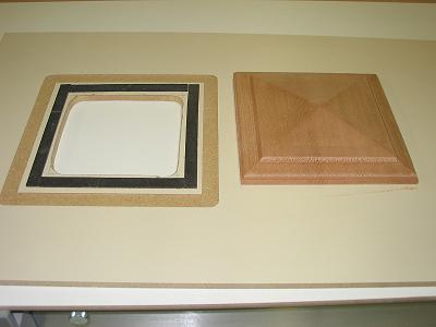

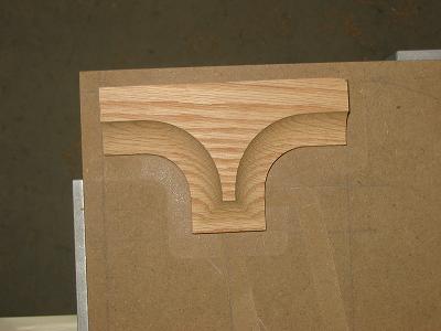

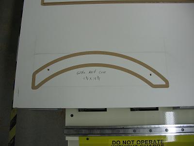

I've been cutting a lot of solid wood moldings for a pair of church doors I'm making. I've been using scrap 1/4" melamine as a holding fixture. I dry run the outline cutting a few thousandths into the fixture so I know where the blank should be. Then I drill a couple of small holes for screws run in from the under side to hold the blank. Flip the fixture and rout away. For some post caps, I used gasket material instead of the screws and cut away much of the interior for vacuum. That worked great. I really didn't need to cut out such a large hole though. The vacuum really works great. The pictures should help explain what I've done.
I'm just learning how versatile this machine is and I've only just begun to experiment. Good luck with your project.

What I have been doing is run the outline on my spoil board then I take 1/16 inch thick foam tape from allstar adhesive and inline the profile . then I drill a 1/4 inch hole through the spoilboard . If I'm concerned about the tape holding up the edges and the middle being sucked down to the spoil board( which will cause your edges to be slightly out of square ) i take some edgebanding with the iron on hot melt and run strips every few inches .There fore creating a grid that holds your part 1/32 inch up off the table. this method is very fast to setup and when I'm done I take a hot glue gun and fill any holes that were created. I usually locate a spoil board with my pop up fingers and then shoot a couple of pins in the corners to keep it from moving accidently when you deactivate the vacuum. I use mdf for all my holding fixtures some times stacked 3 or 4 inches thick and if I want to seal them up I brush on some shellac.
