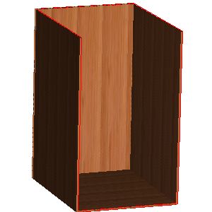

Hi.
Take a look at this "cabinet". It, like all cabinets has an open front to it. However, I am trying to close up all 4 sides and have only the TOP open. In construction setting there is no tab for FRONT, so I can figure out how to close up the front to make a fully enclosed box on all 5 sides. The top would be open.
The project is for a garbage bin (to drop a plastic garbage bin into). The box is decorative and will have a top with a hinge. I built one of these for my wife and it really came out nice. That was before the eCabinets days. I'd like to be able to fine tune the design.
You'll also notice it's built from all 1/4" plywood (not a very strong box). But that's just the shell. I then build outward adding corner joints (3/4" hardwood) that is routed with a lock-miter bit to hide the end-grain. One of the key elements is to build this thing light; it really can't be a heavy box.
So once I figure out how to build the complete 5-sided box, my next question will be how to add the hardwood pieces on the corners using a lock-miter bit.
This box will most certainly use a lot of eCabinets power due to it's non-standard nature. Any help will be great and when I finish it I will post it for you to see the final product. Plus I can post pictures of the garbage bin I already built in the kitchen now. It really beats those white or fancy chrome garbage bins you see in a lot of kitchens. Sure it would be nice to have the hidden one inside the cabinetry, but my kitchen was not designed with that in mind (like many).
Any help would be way cool!
Adam
Box.hsf
(118.02 KiB) Downloaded 1455 times

jerry johnson
Posts: 90
Re: Building a non-standard box
Post by jerry johnson »
Like this, Adam.
TRASH BOX.jpg (34.87 KiB) Viewed 21954 times
8)

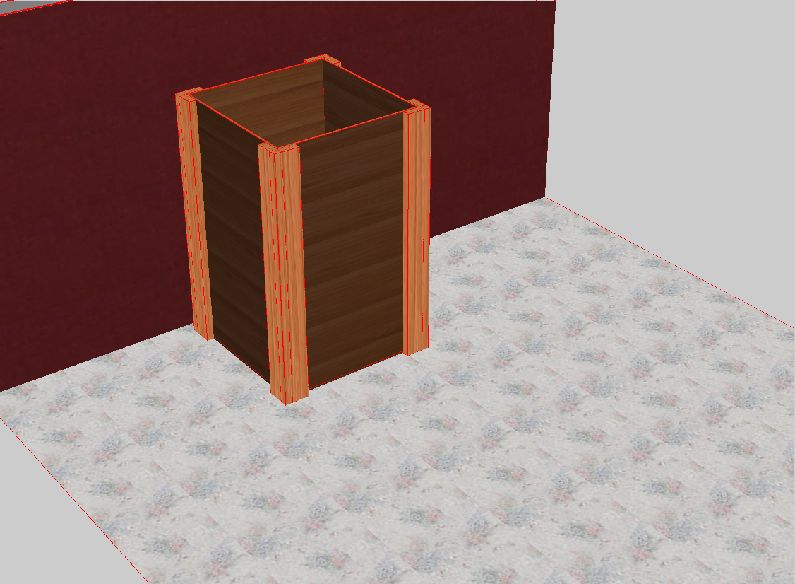

Adam DAgosto
Posts: 62
Joined: Mon, Mar 16 2009, 8:28PM
Company Name: VCC
Post by Adam DAgosto »
It's a start!
Garbage Bin Mod.jpg (56.36 KiB) Viewed 21932 times
