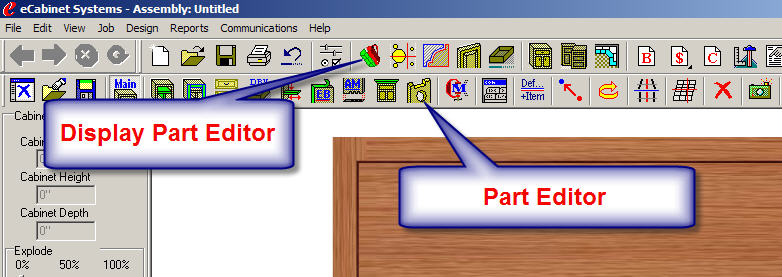

Re: Enkeboll onlays
Just to distinguish between the two, the Display Part Editor is used for texturing 3D objects (HSF, STL files) and the Part Editor is used to modify cabinet parts, Display Boards, Cubes and Panels.
The names are so similar that many users get them connfused and I just wanted to make sure you headed to the correct editor. :beer:
ScotAcree
Posts: 101
Joined: Mon, Aug 08 2005, 6:06PM
Company Name: Scot Acree Woodworkig LLC
Location: Ohio
Re: Enkeboll onlays
Post by ScotAcree »
Dan-thank you for clearing that up for me,I did know there was a difference,just did not know what to call each one.
