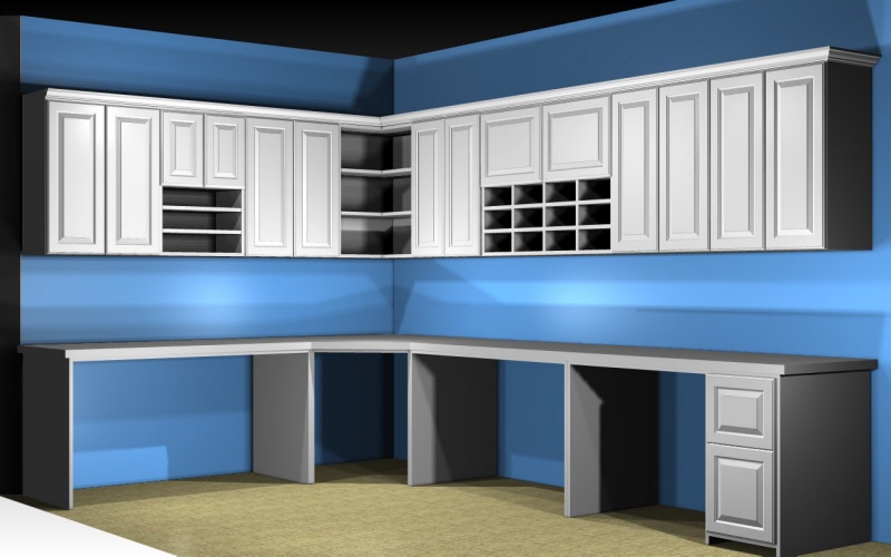

Just a small office, my concern is the end panels don't want any fasteners to show. Never used RTA fasteners, was wondering if biscuits would be strong enough

WIth that one I'd use a combination of biscuits and screws. Screw together the cabinets that aren't seen, purely because its quicker assembly, and biscuit the areas that need it only.
Hope this helps

For example, the only cabinet I'd buscuit in the attached job would be the RH side of the bottom shelf in the microwave cabinet. The rest would be screwed together. The panels then get screwed on from the inside of the cabinet..
