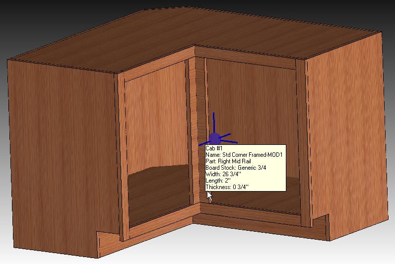

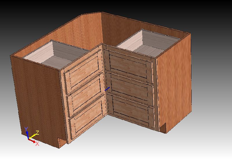

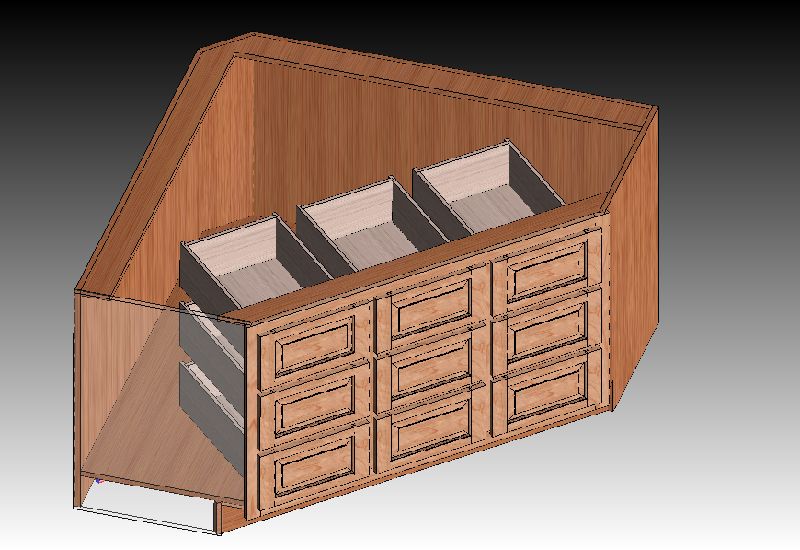

I am not sure what you are looking for
Test Corner Cab 12-2-09_3.jpg (66.6 KiB) Viewed 5292 times
Test Corner Cab 12-2-09_5.jpg (67.48 KiB) Viewed 5292 times
Test Corner Cab 12-2-09_4.jpg (79.35 KiB) Viewed 5292 times
