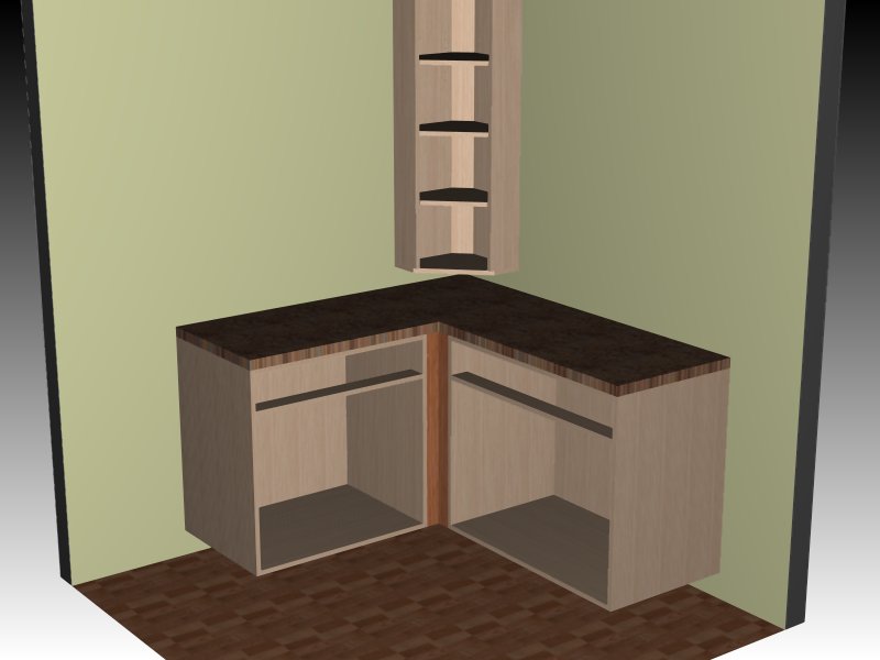

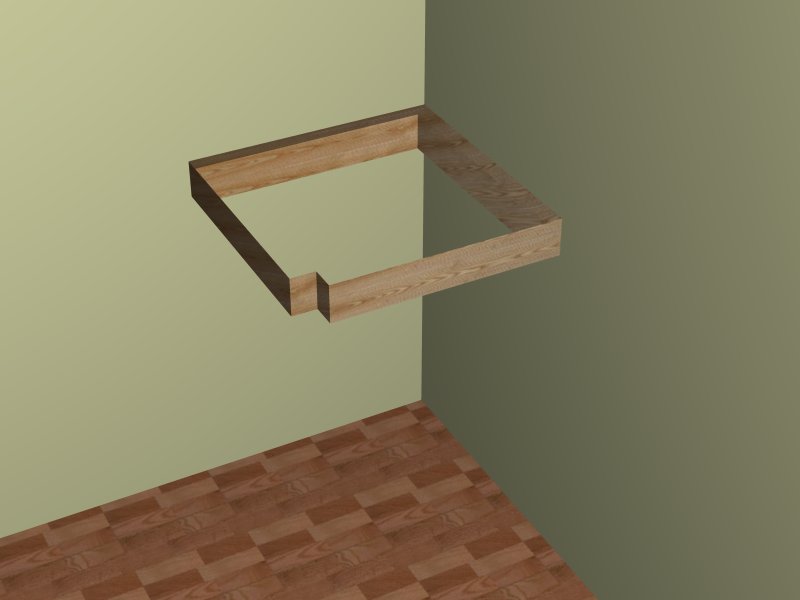

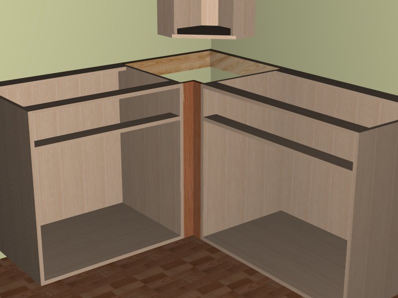

Darren here are the steps to take to construct a counter top. Because of the way I uploaded the last step shows up first .
View 3.jpg (11.57 KiB) Viewed 22118 times
View 2.jpg (25.68 KiB) Viewed 22118 times
View 1.jpg (22.49 KiB) Viewed 22118 times

Re: countertop question
Post by Gary Puckett »
Then construct the counter top
View 4.jpg (9.24 KiB) Viewed 22118 times

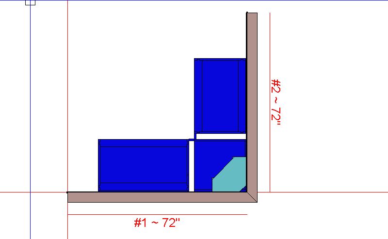

Here is one that I use for the corner
The way I look at it is do need to put studs on the walls to hold the counter top up right.
My corner stud cabinet can be resized
The corner 2-1/4"filler is a corner cabinet and the filler can be resized in to the left or right.
The right can be 6" W and the left can be 2" W
ladd bath_New.esj
(2.81 MiB) Downloaded 1079 times

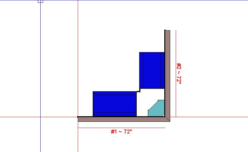

My corner studs for the counter top
