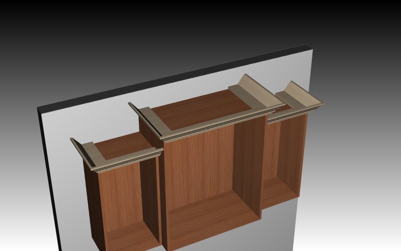

Neal, here is an example of cabinets that are saved as crown moldings. All sizing can be manipulated as your placing them in custom layout. Texture matching is also easy by just changing sheet material. Re-sizable fillers, panels and valances, etc. can easily be constructed this way too and added to your library. The key thing to remember is to use a cabinet part.
- Attachments
- Center Crown.hsf
- (110.02 KiB) Downloaded 868 times
- Crown Example.jpg (34.1 KiB) Viewed 10751 times

So I should create a directory called "crown moldings" and put cabinets in them in which I delete all parts of them except for the tops. On each cabinet, I should crown it in a different way in order to create a "crown molding cabinet" for each and every scenario. Am I understanding this correctly? This makes a lot of sense and I will try it. However, I think my way would be easier.
