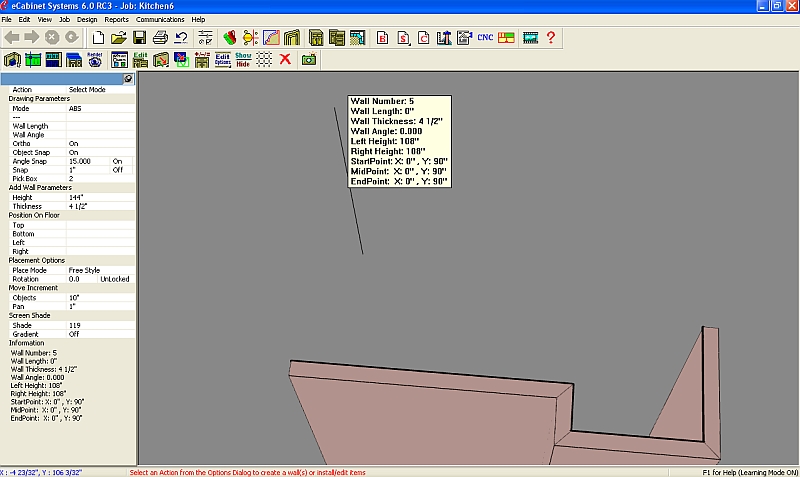

Re: Job Will Not Render
Rob,
I kept seeing a line in the wall in the middle of your window so I deleted the window and the wall and when I mouse over the line it comes up as wall number 5 with a length of 0. see picture
This is what is causing your problem. Save you cabinets to a file then do the wall starting from scratch then place the cabinets again. Make sure you start a new job to draw your walls.

Kerry, I'm not sure how you found that, but you are "DA MAN"
I just did a right click and selected all walls and hit delete, so I guess it took that one out also. I had to unselect one wall as it would not let me take them all out. I decided to leave wall one and it worked. If Rob deleted the walls one at a time, I guess he would not have gotten the "sneaky wall"
Kenneth

Thats funny because I did see that line and was wondering if it had something to do with it. When I deleted walls I guess I still did not see it.
If I paid more attention to the wall list I would have noticed it.
I ended up starting from scratch again.
Thanks again Kerry for figuring this out.
And you were right Kenneth it was something to do with the walls.
