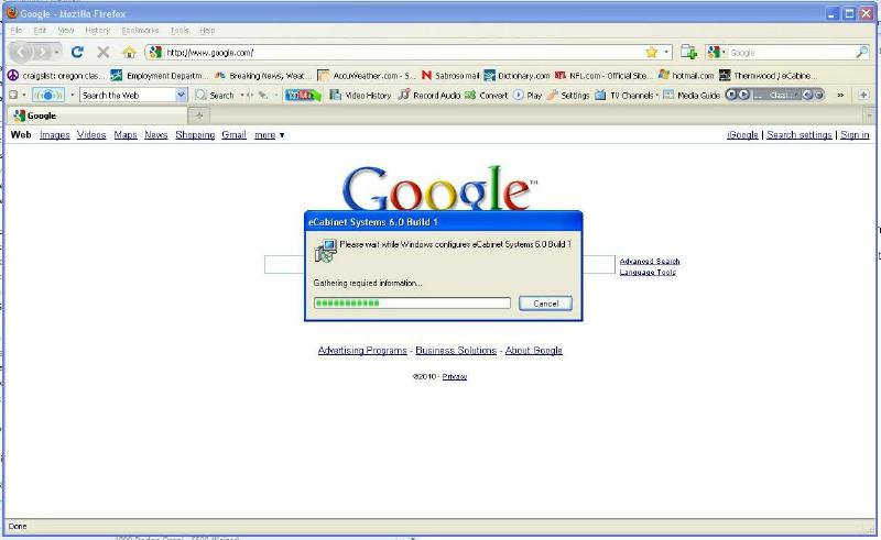

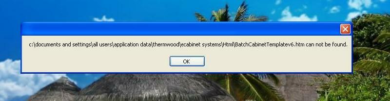

OK I ran V6Build1Setup1h.exe to uninstall, and that completed successfully. I ran Ccleaner to clean out old registry entries. Then I ran v6B1TestSetup2b.exe, and installation finished successfully. I then tried to run ecabs, and got the error messages in clip1 and clip2. I input the new registration code, and ecabs loaded up but without the initial startup page, error said "could not display page" or something like that. I closed ecabs, and when the pc was idle, ran firefox. Just a few seconds after Firefox was loaded, the ecabs install box popped up again, same as before. This is seen in clip3.

Sorry it has been a few days since I have been able to get back to this. By any chance, have you verified that the file is in this location that it claims to be missing from? This is what is tripping the Installer to attempt repair, but I am unsure as to what might be causing it to be missing if in fact that is what is going on.
Some things maybe to try would be to disable your Anitvirus suite and then run the install. It might be possible that since this is an HTM file, that the program is either changing the name or re-directing this to open in Firefox when the program calls for it.
Another thing to try, and I already know you really don't want to do it, is to change your default browser back to Internet Explorer (IE), run the installation program and see if the problem goes away. Assuming that it does, and eCabinets is up and running fine, then allow Firefox to take back over as default. Hopefully, no association issues will come up causing the problem to happen again.
