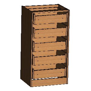

Hi,
I have added part editor onto our Drawer boxes, now when I come to resize the unit we are getting an error. This has only started happening since I added the part editor cuts, the units resized without these cuts.
I have attached the unit, so if anyone can help out or has faced this issue can they let me know.
Cheers,
Leigh
0140 - 5 Drawer Chest - Over.hsf
(2.4 MiB) Downloaded 942 times
0140 - 5 Drawer Chest - Over.jpg (14.4 KiB) Viewed 8053 times

Leigh,
Will you please verify this for me: Is the error you're getting "There was an error while adding or removing tenons for the Top Stretcher Front........" and then a message "There was some problem while regenerating the Front Top Stretcher Press YES to lose PE cuts or NO to revert to old cab"? and then the same for the back?
are you saying the drawer boxes lost the PE cuts? If I answer yes to remove PE cuts for the top str front and Back, it will resize the cab correctly and the drawer boxes will resize and keep the PE cuts on them too. Please let me know. If you are seeing what I am seeing, then I have reproduced this from scratch and will have it resolved. If you are losing PE cuts on the drawer boxes, I will need more info from you.
