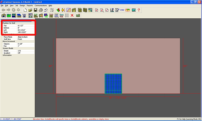

New to ecabs and doing the videos. getting the info on the vids (ie. re-watching) proves difficult due to the titles of many videos having similar headings in different chapters. Specifically, once I place a cab on a wall, how then do I put it in the place I want?
Re: how to mave an object?
Chris,
Go to the wall elevation view and click on the cabinet to select it.
at the left upper corner of your screen you will see nemerical entry boxes for the Position on wall
enter the correct values there.

Got it, thanks!
