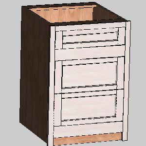

I tried running the right side to see if the holes drill but they did not.
Thanks for taking a look Rick.
24 .X 34.75 x 26.5 Draw Base.jpg (18.1 KiB) Viewed 45239 times

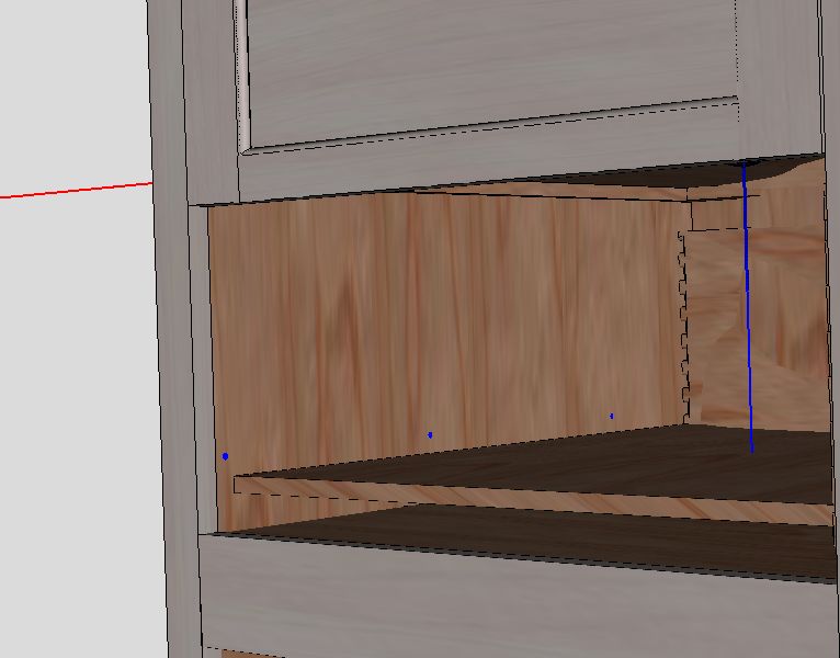

Re: Problem with holes showing up
Hi Nick, what I have found out is the pattern doesn't seem to want to stick to a face frame cabinet. It shows in the CE, but it wont nest. A frameless cabinet will nest with the pattern. I have tried different hole depths too. This could be a bug. Maybe someone else can give it a go.
Hole pattern.jpg (41.33 KiB) Viewed 45140 times
