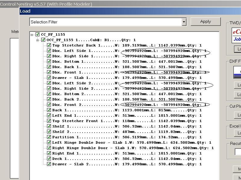

CN FREEZING in 5.57&5.56 ALSO(negative dim -507994920mm)
Post by mohan kommineni »
HI all
we are facing a problem in cn5.57 & 5.56 after loading the job we can find the drawer box sides and front coming up with a very big negative dimension and causing system freeze but practically there are no left and right and front sides on this drawer box as we are using metal slides standard part
what is causing the mess and negative dim -507994920mm
mohan
ControlNest5-57.cab.txt
machine export file
(69.49 KiB) Downloaded 1108 times
CC_PF_1155twd.txt
twd file
(224 KiB) Downloaded 1167 times
snap shot of negative dimension of drw box which doesnt exist
dimension issue.JPG (124.44 KiB) Viewed 14464 times

This is an issue with eCabinets that will be resolved in the next update to Version 6. There were changes performed for optimization in Control Nesting that exposed the error from eCabinets. Until the release of Version 6 Build 4 you will need to uncheck these problem parts in the Load screen. Sorry for the inconvenience.

i also noticed one more issue in cn once nested if gong back into load menu due to any reson all the dimensions are in inches we are using mm

Looks like part width and length are getting multiplied by 25.4 an additional time when returning to the Load screen. This will be resolved in Control Nesting 5.58.
