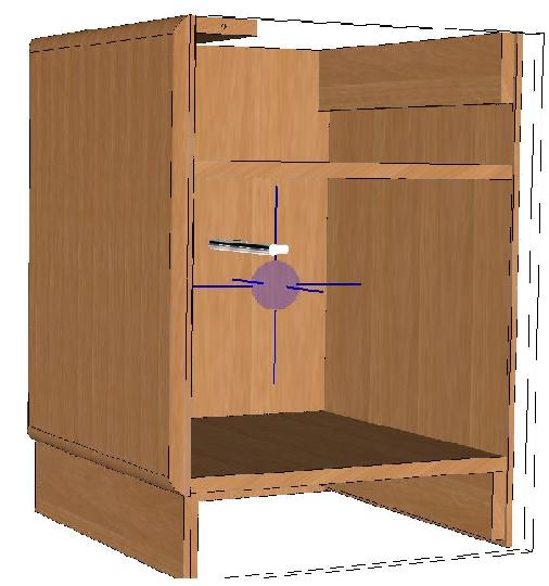

Another thing I have noticed with the door/drawer pulls is that when associating the drawer pull the handle is displayed on the drawer correctly, however when associating the door pull the handle is placed in the centre of the unit. I think this has only been an issue in V6, is there a work around? Am I doing it correctly?
Re: Amerock Pull
Leigh,
The default location for door and drawer front pulls in eCabinets is the center unless you change it.
In the door/drawer front editor click on a door to select it then click the Add/Locate Pulls button.
A dialog box will open for you to position the pull on that door. If the door you chose is a left hand door then this setting will be in effect for any left hand door you place on this cabinet. Repeat the procedure for the right hand door.
This information will be saved with this cabinet and will also be in effect for any cabinet you create from this cabinet.

Ok, I have narrowed the problem down.. It seems that I am just getting this fault with LH hinged doors. When I associate a handle to a RH hinge door it is fine.
Re: Amerock Pull
Leigh,
I see what you mean now. What pull is that?
Have you tried a different pull to see if you have the same problem?
Post your cabinet so we can look at it.

Its happening to all my units with a LH hinge door, I have also tried a variety of differents handles pulls.
0300 - Bedside Cupboard Drawer RH Door.hsf
(742.02 KiB) Downloaded 1951 times
0300 - Bedside Cupboard Drawer LH Door.hsf
(744.02 KiB) Downloaded 1986 times
Re: Amerock Pull
Leigh,
I get the same results you do using your cabinet.
The eCabinets guys will probably want to look at this.
Re: Amerock Pull
Leigh,
It is a bug using MDF doors. I get the pull problem on my cabinet if I use an MDF door.

like I said we didnt used to get it in V5 so its since the upgrade.
