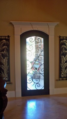

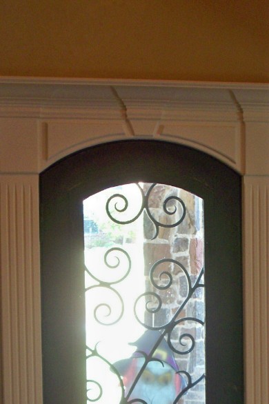

I'm having trouble cutting a concave arc in a display cube. I know start stop points and the radius but I'm not sure how to use those to make the cut I need. The fillet tool uses the info I have but it only makes convex cuts if I'm not mistaken.
In the attached pic I'm trying to make the "horn" pieces on either side of the keystone.
The cube is 10-1/4" x 27-1/8" and the radius I need is 38-3/8". I need the arc to start at one corner and cut off 6-1/4" off the other short side so it leaves 4". I hope that makes sense with the pic.
It this possible or do I need to calculate a mid point and use the arc tool?

Thanks for the responses but the part I'm having trouble with is drawing the concave arc using just the known radius and 2 fixed intersecting points.
The "fillet tool" requires the radius and 2 intersecting points, which is exactly what I have, but from what I can tell it only will cut a convex radus. So how would you go about drawing the arc to start with?

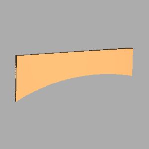

Travis,
Is this what you need?

Gary,
Thanks for the help. Yes that is what I needed but Kerry answered the main question. It just seemed like if the fillet tool could do what I needed there might be a way to do the same for a concave cut but I guess not.
