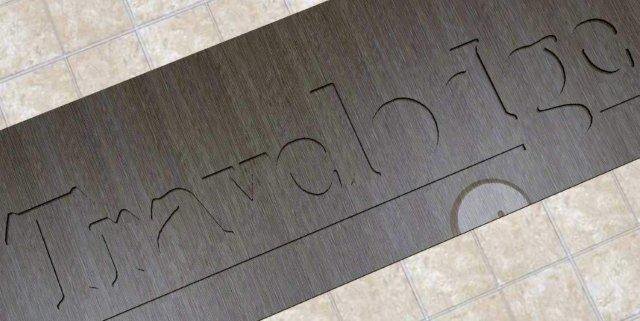

I fixed your DXF and used it on a display panel in eCabs and generated this JPEG of the result. I hope it is clear enough. One of the immediate problems is that it removes the centre of closed letters like "O" . The other problems I had only become apparent when you actually start machining where you get some letters becoming larger because it cuts on the wrong side of the line

Oh yes almost forgot!! One can fix the problem of the removal of the centre of the letters by splitting the letters down the centre. I am not sure how it would physically machine though. If you like I will create a TWD file for you to try just give me the gross dimensions of the sign. I know it must be 32" but how high?
