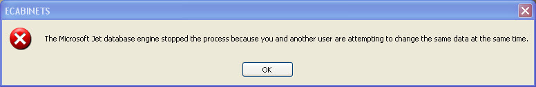

I have received this error message upon starting the program today. The latest update(s) have been applied, and the program won't load once the error message pops up. Anyone have an idea/solution?

Can you zip up and post your localstore.mdb?
It is found at
Vista/Win7
C:\ProgramData\Thermwood\eCabinet Systems\localstore\LocalStore.mdb
or
XP
C:\Documents and Settings\All Users\Application Data\Thermwood\eCabinet Systems\localstore\LocalStore.mdb

I assume you are on XP. The {Application Data} folder may be hidden on your PC. Can you navigate to {C:\Documents and Settings\All Users}? If you can, you can navigate to {All Users} and then click in the address location and add {\Application Data} to the end of the path and press enter. This will take you into that folder even if it is hidden. Other option is to set your folder options to show hidden files and folders.

This is because you have Windows set to hide extensions of known file types. Hover over one of them and the pop-up window that reads {Microsoft Office Access Application} in it will be the one we want (but NOT the one that says record locking information if you have a 3rd file showing).

Unfortunately, the latest update did not fix my problem, and I don't have this issue on the notebook. Here is the requested LocalStore.mdb.

This file is what is causing your troubles. Delete it or rename it and then run the install and select the repair option. This should get you going. If you had any hardware components added, you will have to add them back in.

You, are a genius. I ended up having to delete all the LocalStore.md* files, but things seem to be up and running again.
