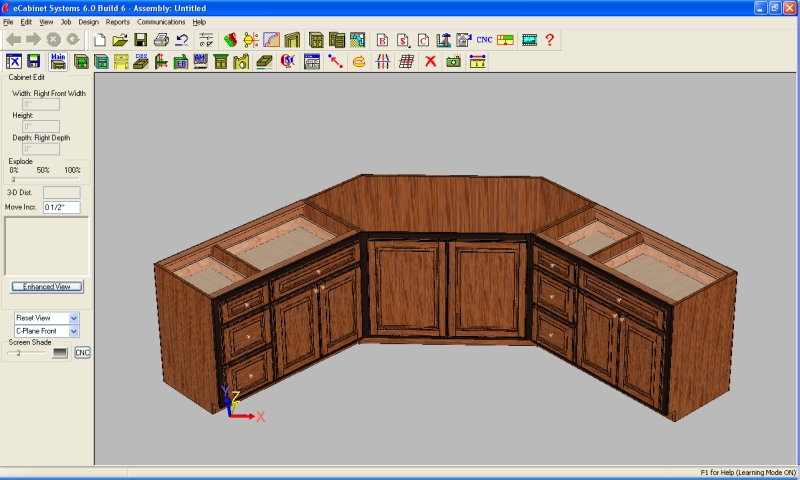

Are you looking at something along this line?

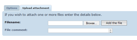

At the bottom of the page that you are posting on is an "Upload attachment" tab. You can browse to the file, then "Add the file".
Dennis
Upload Attachment.png (6.58 KiB) Viewed 11219 times

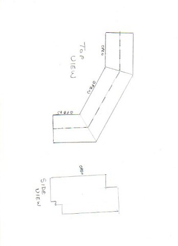

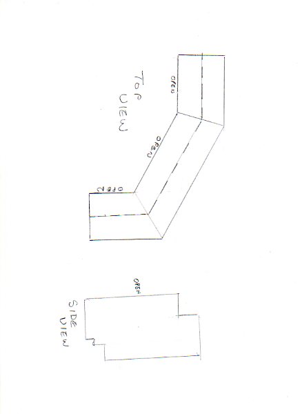

This is a rough drawing of what I trying to do

You just use the corner settings in Construction Settings -- see pic -- Image
