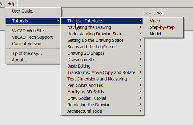

HI Neville
I us Punch! ViaCAD Pro v6
I started with ViaCad 2D&3D Punch sells it for $99.00 it will do anything you need for e-Cabinets.It will export DXF & DWG and STL and convert file.
They have Tutoriols with Videos
http://www.punchcad.com/c-12-consumer-cad.aspx
I buy a lot of my software from NothingButsoftware
They have ViaCAD Pro v6 right now for $199.00
http://www.nothingbutsoftware.com/catal ... ode/123487
Staples did sell ViaCad 2D&3D for $69.99 they don't have it on there Web.page anymore but they tell me that some of there stores still have some on there shelfs
