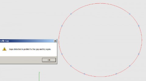

An oval or ellipse has two different radius so I don't think a circle would work. (I don't think eCabinets has the ability to draw a circle from three points anyway. Just from a radius) There is some trigonometry to draft an ellipse but it was over my head.
Have you tried it? Your drawing just looks like a circle.

It is your DXF file you made in Delta Cad with a 17" dia and a 15" dia
Re: Profiling a oval shape
Kerry I see how slow your DXF is in e-Cabinets but then when I put it in ViaCAD and save it as a DXF from VC it is alot faster in EC ?
When I put your DXF in my DeltaCad and bring it out it will not work in EC? Then I took the DeltaCad DXF into VC it opens it all up. Here is a picture of it all opening in the oval.Try the DXF from VC I didn't do anything to it in VC

ViaCad created the oval as just sixteen arcs (Instead of many, many straight line segments) which works great.
It works fine in eCabinets. I am supposed to be able to draw an oval/elipse in Intelicad with arcs but I haven't learned how yet. From what I have read, if an oval is created using seegments it cannot be converted to arcs. it must be drawn using arcs.

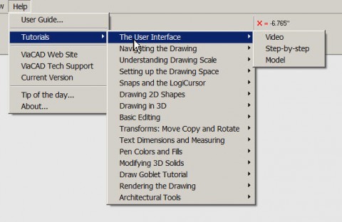

I us Punch! ViaCAD Pro v6
I started with ViaCad 2D&3D Punch sells it for $99.00 it will do anything you need for e-Cabinets.It will export DXF & DWG and STL and convert file.
They have Tutoriols with Videos
http://www.punchcad.com/c-12-consumer-cad.aspx
