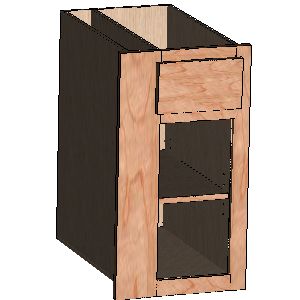

Scott, attached is one of the cabinets in this job. Thanks for your help with this.

Your negative .02 fit clearance is nesting as a positive .02 so i would return that to 0.
I nested your cabinet using a .597 material with 0 fit clearance and the dadoes nest .597 so this seems that it would be a setting at the machine Control Nesting that is causing the problem. Does your bit measure .5" actual diameter?

I called and talked with Darrel earlier today about this issue. What I have discovered is that changing the fit clearance globally will not apply the value to fixed shelves and partitions. So, what he was experiencing was wide dados for these parts only. It has always been this way and I am surprised it was not discovered until now. We will change this, but to get around it for now, you can go to the shelf/partition editor, highlight the shelf or partition and then go to construction settings and it will apply it to the part.
