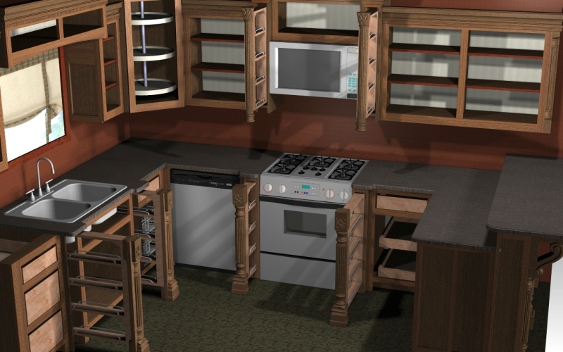

Fred,
You can add any hardware you have placed in Preferences/Define Hardware.
You can add the hardware items to the Cabinet buy list if you just want them listed in a bill of materials or you can use 3D models of them and add them as Hardware Objects and have them in the bill of materials and show them graphically as well.
That is what I have done with the hardware in this job.
