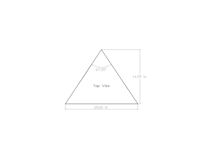

Re: pie shape lower
Fred,
Is this what you are looking for. I will have to play with it a bit more to get your exact measurements.

Re: pie shape lower
Kerry that is it. Measurements above are not necessarily what I need. I'm mostly just trying to figure out how you did that. We get all different measurements and right now in the dark ages esentially making on table saw.
Thx
Fred
Thx
Fred

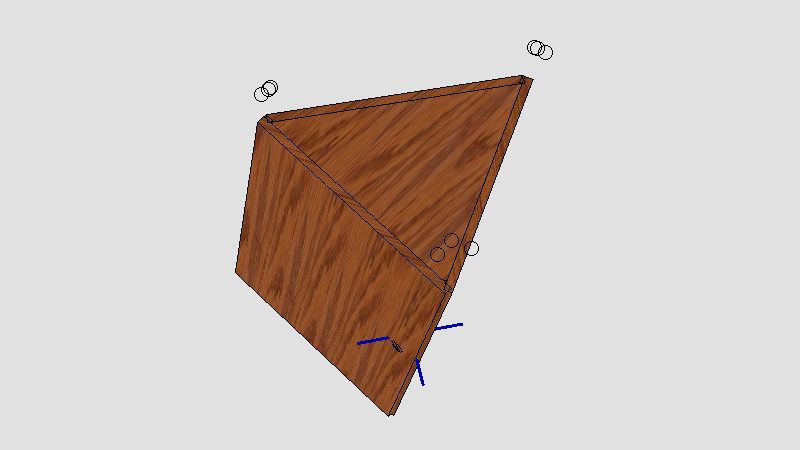

Re: pie shape lower
Fred,
I have attached the cabinet I was playing with for you to look at. I am not sure it will work though. I had to use a display panel for the back so it won't automatically re-size.
I will keep playing with it.

Re: pie shape lower
Kerry, is there any way to use a back in place of the display panel?
- Kerry Fullington
- Posts: 4735
- Location: Amarillo, TX
Re: pie shape lower
John,
This was done using a corner cabinet and with the three piece back I can't get it to work. The center back is just a bit short to make the cuts.
I am going to try this using a miter fold.

Re: pie shape lower
Kerry,
That is it. I still need to get my head around the corner cab numbers and what all changes. Display panel is not a problem.
Fred
Fred
