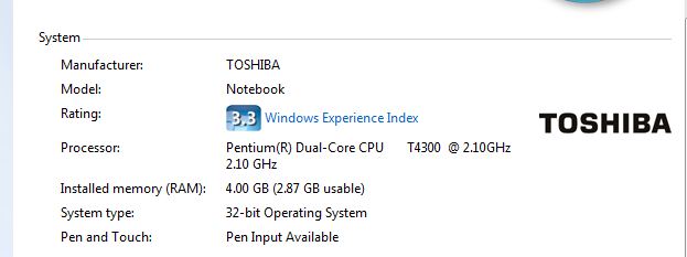

I am using the Toshiba satellite L510. It runs eCabs........okay.
I don’t know why, sometimes it seems to run better than others. But that’s not logical is it?
On larger jobs I often save and close as advised by other users, which can save grief and seems to keep it more stable.
I wouldn't like to cut back on any of my specs as I think it would impact more on performance.
But it's what you get used to.
Even though my unit is a dual core I don’t think eCabs uses any dual core capability.
I like the portability of the laptop; it’s a lot easier for me to carry the job I’m working on around
I don't seem to have issues in the areas you describe but I have given up on the bench top editor (It’s been so long since I went in there I forget fully why) but something I do causes it to crash.
Hope this was useful to you
