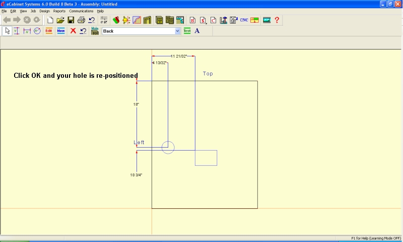

The particular example of using the pick box to highlight the rectangle or circle to cut a hole and being able to move and scale it by dragging on it is much easier and quicker than the process you were kind enough to provide.Kerry Fullington wrote:Scott,
Yes those tools are available in eCabinets. The eCabinets programmers have kept the tools very simple while still providing the the features needed to build cabinets. These tools meet the needs of a cabinet shop but of course are not adequate for a graphic design artist. To provide the tools Tom is wanting would make the learning curve much steeper and would most likely bloat the program as well.
