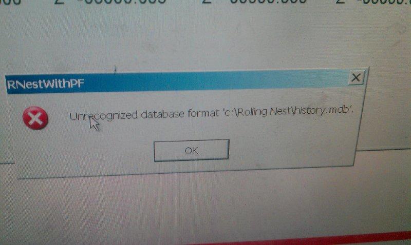

Hi Everyone,
I need some help..
We picked up problem : unrecognized database format C:\Rolling Nest\history.mdb on SuperControl V7.
Obviously now nothing works.
Any help please !
Conrad Du Plessis

Solved. Easy enough. As was suggested I renamed the history.mdb file to .bak
Then simply re-started SuperControl and, success ! A new history.mdb file was created, all good !
Thanks for your help !
