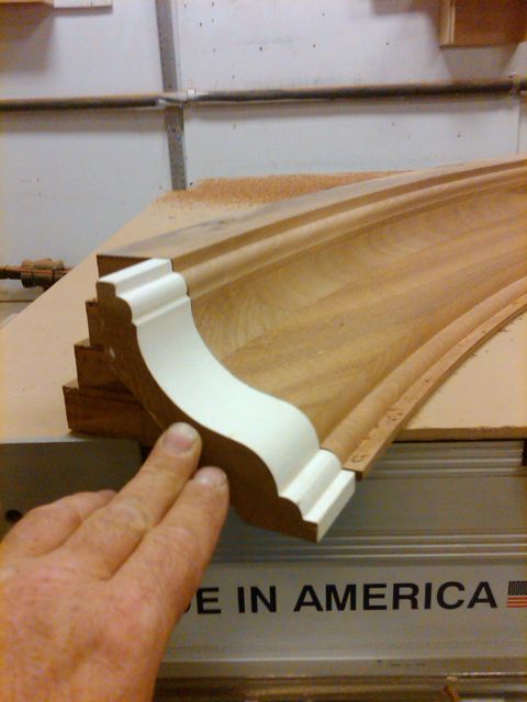

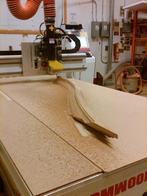

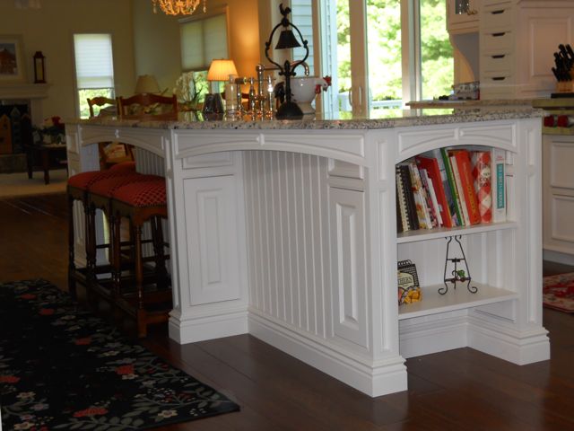

Samples of some of the projects I made using only e-cabinet software.
But more times then not I find that ecabinets is not a 3d modeling.
But as a cabinet soft ware I doi not think there is any better.
