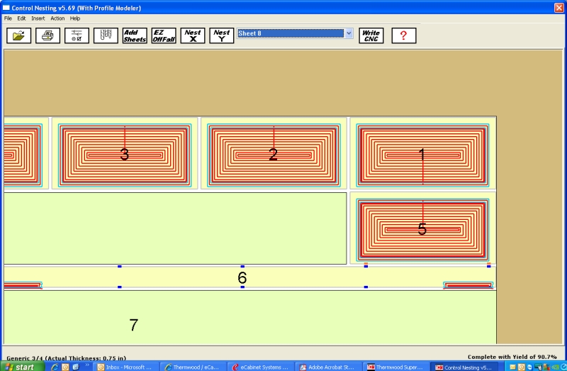

These are some adjustable shelves that I did a through pocket cut (using Closed Contour) in the eCabinets part editor.
I want to cut them out, not turn them to dust.
I have tried changing the Pocket Area (Through Cuts) setting in Control Nesting (down to 1^2) but it still wants to make dust out of the centers.
What am I setting wrong?

Kerry, I think you have to set your desired tool to pocket and Rout/Dado.

Kerry you can also use a "interior" or "exterior" tool and a profile to get what you need if you can't make the pocketing work. I'm sure you already thought of this though....

Kerry, after looking into file it seems you are wanting to cut a lip, maybe for a glass shelf....Control nesting does not support this type of cut yet...It should see a pocket cut inside a pocket cut, but as of right now it is wanting to pocket the whole area to the .25 lip depth and then do a through cut ...it should cut correctly but with the unnecessary full pocket routine.

I am going to use Josh's suggestion and pocket the center then use a profile to cut my rebate.

I hope you got it cut , Kerry. What I do there is make the thro cut as 1 pocket, then offset the rebate .1mm out from it. Works fine.

I got them cut fine. I was even able to add a pass with a 3/16" tool to square the corners.(and after, decided I didn't like plywood so I tossed them and built the shelf frames out of hardwood)
I didn't think about adding a little space to create two separate pockets. Thanks for the information.
