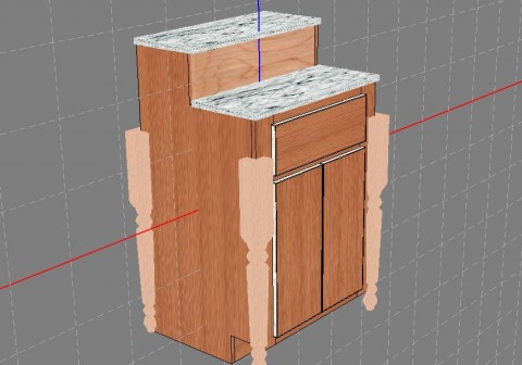

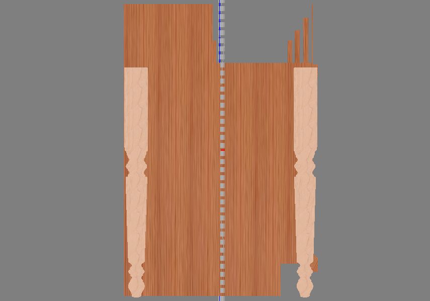

I was asked to present a propossal of an Island with the countertop in two levels, the drawer side lower than the oposite side, I cut both sides and the top of the island cabinet in part editor but I can not resize the opening for the face frame? I understand that are different ways to do the same. maybe my aproach is wrong?? Any help will be apreciated

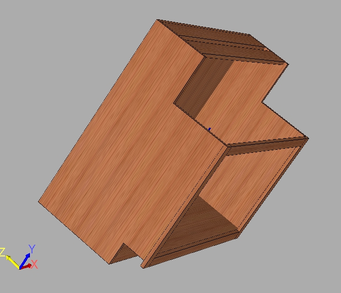

The island only have drawers and doors in the front part, the top must be at two levels being the front the lower and countertop on both levels. I cut the lateral panels to resemble two levels but the face frame take the higher level and I dont know how to define the opening lowering the top side to put the face frame and the drawers and doors. I even put a stretcher on the top side of the lower part with no result

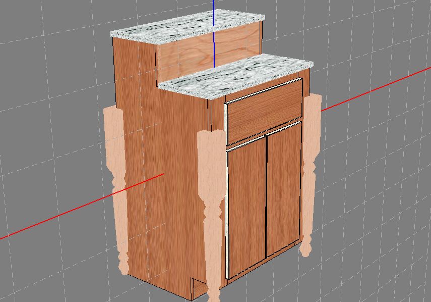

Mario,
Under Construction Settings/Face Frame Tab give your top rail a Negative Outside Scribe equal to yourcutout depth. This one has a negative ten inch outside scribe.
