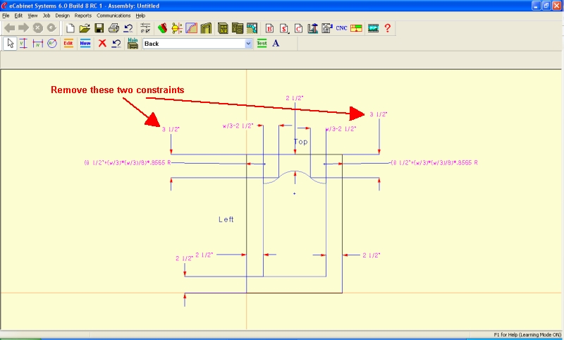

Would someone be kind enough to look at this door and help me with the constraints. I am able to constrain the arcs to resize like I wish when the width changes but now the height of the door won't resize at all. Thanks for any help.

Re: Help With Constraints
Scott,
Remove the two constraints in this picture and see if it still doesn't work properly.
Scott,
I think there might be a bug in this. I can adjust the height of your original door if I use small increments.
example - I can adjust the height from your 21" to 23" then to 26" then 30" and it works but if I try to go from the 21" directly to 30" it does not work.

Thanks Kerry for your response but I may have to start from scratch on this one. Try taking it from 14 1/2W to 32W That won't work. Maybe some one out there has done this type of door before? I sure could use some help on this.
