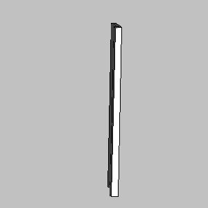

Re: Scribes and end panels
Hi Alex
Another alternative to Ricks.
An end with a door, no hinges.
fillit LH700x30.hsf
(78.02 KiB) Downloaded 1027 times
fillit LH700x30.jpg (3.76 KiB) Viewed 18394 times
