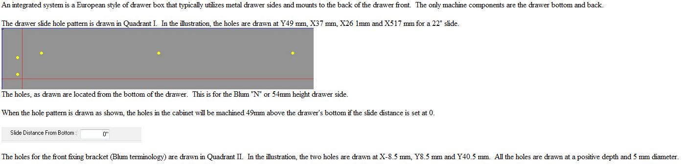

Here is the pattern. I've tried looking at the help manual where its says that all holes should be drilled in a positive direction, doen't seem to work. I've tried every combination of holes, with some positve on the draw front but negative on the side and vice versa, both positive and both negative, but I'm getting the same drilling. I've even tried making a pattern using the sample in the help directory but it's still not working.
Anyway, attached is the pattern. The drilling for the draw front should end up 17mm in from the cabinet insides. As you can see, the pattern ends up drilling 17mm OUTSIDE of the cabinet internals. I've renamed the .ptn extension to .txt to get it to upload. Thanks.

You are probably expecting the holes to reference with the inside of the cabinet box and move inward similar to the hole patterns that most slide companies supply. It however works the opposite and references the edge of the drawer box and moves outward. That is how you set up the pattern. As a beta tester it stumped me for an hour until I realized it didn't work the way I expected. Until they get this fixed you will only be able to add holes for the front brackets (no metafiles). I had hoped to be able to add holes for drawer front adjusters and a few other items that require the hole to move inside the left and right side of the drawer box. Those will stay on the back burner until they get it fixed. Forrest

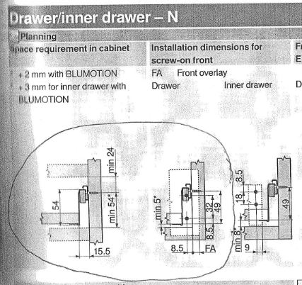

Ah Hah! I think I've got it now. When I've designed my draw boxes, I have designed them in the draw box designer to automatically take off (in Harns case 34mm each side internally) so that when i place them in any width cabinet I don't have to put any value in the left and right drawbox inset. This is useful because we use that many types of draw box - (we go by what architects specify) - and having the deductions done automatically is a lot easier, and a lot less prone to mistakes than manually entering a figure every time you put in a draw box. I'm wondering if this is going to lead to further issues down the track.....

*EDIT - this is still not the way it is described in the help files from what I can see. The way I see it this is referencing the inside of the cabinet just like the Blum catalog. For your info the draw base for a Metabox draw is inset 15.5 mm each side internally. The inset internally for drilling holes in the back of the draw fron is 8.5mm....
See the pictures attached.
