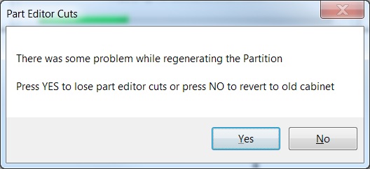

Any ideas on why eCabs is chocking on this cabinet? I can't find anything wrong with it but I'm a little drained right now trying to push my way through editing dozens of cabinets and having eCabs randomly crash on me loosing all my changes. Plus for some reason it starts running really slow and I'm not sure why. Very frustrating....
Problem regenerating PE cuts for a partition
- Posts: 833
- Location: Newport, WA
Load the attached cabinet and take it to the door/drawer editor. Now add double doors in the large center opening. Return to the cabinet editor and a dialog box (attached) comes up saying it can't do something - do I want to let it mangle or unmangle my cabinet.......

Re: Problem regenerating PE cuts for a partition
Don,
Not sure what the issue is here, but if you regenerate this cabinet (con-settings, then OK) then all seems fine and the doors will add in just fine. It appears that the issue was with the left partition. I'll have the programmers analyze it to see if they can deduce why it was failing prior, but all should be good for you after the regeneration.
Thank you Scott. I must apologize. I didn't remember you had to regen for this. I will do that from now on.
