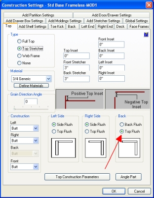

Re: How to add Dados to stretcher?
Chris,
When you set your Top Construction Parameters to Stretcher make sure you set the Back to Top Flush.
See Picture.
Then it should work.
