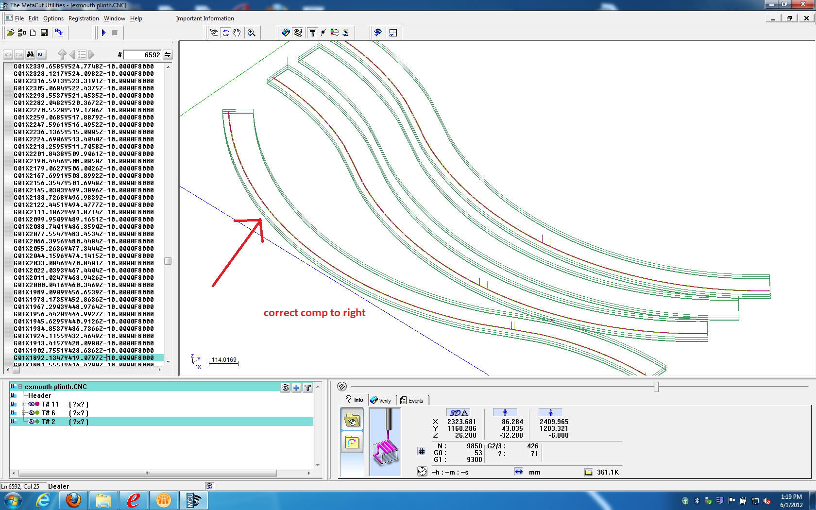

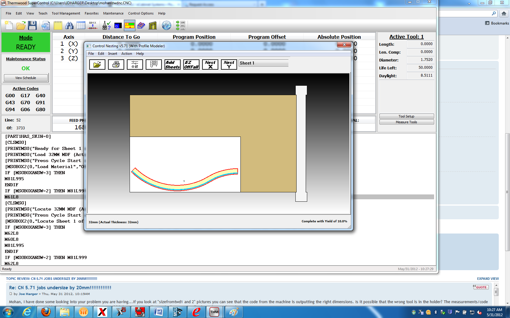

Mohan, I have done some looking into your problem you are having...If you look at "sizefromtwd1 and 2" pictures you can see that the code from the machine is outputting the right dimensions. Is it possible that the wrong tool is in the holder? The measurements/code show up good here and is being compensated with a G42 which is correct according to the "Conventional" tab you have selected.

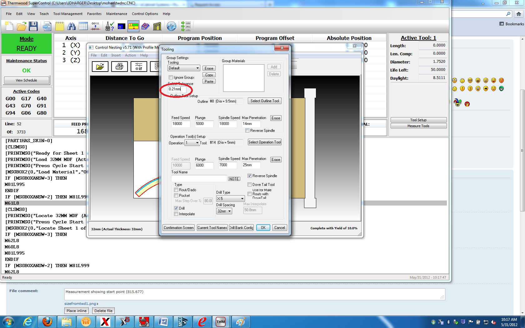

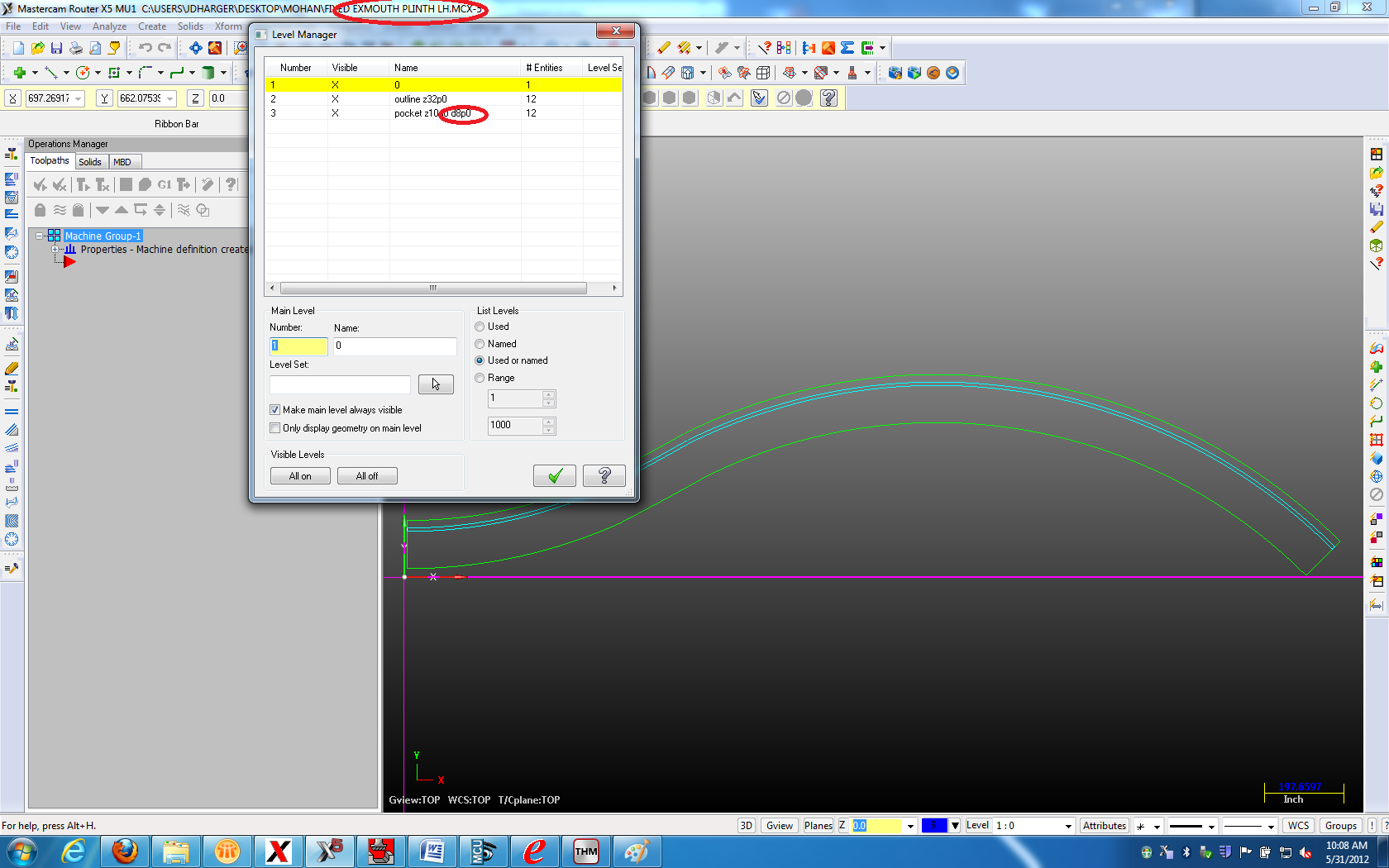

About the DXF file....the dxf file you have EXMOUTH PLINTH LH.DXF....we can see you have d8p0 tool defined to cut with (picture dxf_8mm_layer), but in tooling there is no 8mm tool set up...There is a 7.8mm tool set up and your tolerance is at .2mm. With this settings we are getting the error..(This error message is indeed incorrect >>it should read 8mm tool), but it is still looking for the 8mm tool. Continue on next post>>>>>>>>>>>>
Joe Harger
Re: CN 5.71 jobs undersize by 20mm!!!!!!!!!!!!
If I change the tolerance in tooling to a little bit past .2 to .21 then it nests fine as is.....
If we set up a 8mm tool and leave the tolerance as is at .2mm then it nests fine also...
Also, if we take out the d8p0 in the layer name then it nest fine as well
I hope this lets you nest with DXF option and everything should be okay...once we get your New export file we can take a closer look as to why the part would be cutting undersized, although as we have verified that the code is being output correctly.

correction in my cn settings as you said .21 group tolerance had given the way clear to nest the job and only through dxf but not through ecab and twd
please go through the issue and see wheter or not you can find an bug in CN for ecab and twd

Mohan, We checked your cnc file and created new ones various ways with layered dxf file and creating the part in eCabinets using the DXF file to cut the part... we have checked multiple scenarios using your dxf file as a layered dxf and creating the part in ecabs from the dxf by cutting the part from it and all come out correctly...what is happening in your cnc file you sent is that the RH parts are being comped in the wrong direction(G42) whereas the LH part is being comped in the correct direction. We can verify this with our simulation software..
..You didnt say if some of the parts were okay but by looking at your cnc file the LH should be good whereas the RH and solid should be the 20mm undersized because of it comping in the wrong direction...Can you repeat the steps you used to create these parts in eCabinets...We have tried to mess it up by doing various things but cannot get it to output incorrectly....We have brought your DXF file in and mirrored the geometry in Contour mode to cut part and it still output code correctly...We have taken panel into the part editor and flipped it to the back view and created(cut) part from the back view and it still outputs correctly..It has to be something where certain steps are being done to generate incorrectly. Hopefully you can create this scenario again and we can look into it further..
