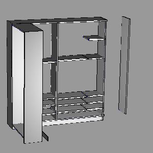

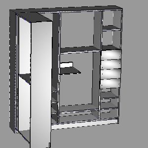

Attached is a wardrobe that i am creating that i have had a could of problems with the draw box is randomly in middle of unit before this the
partition was 1000mm to the left of the cabinet.

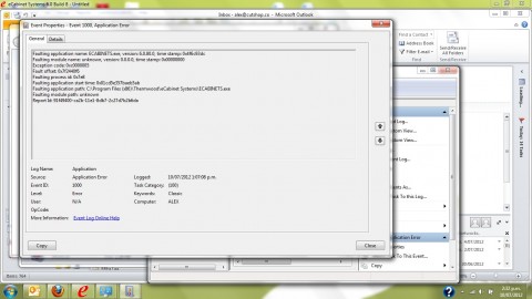

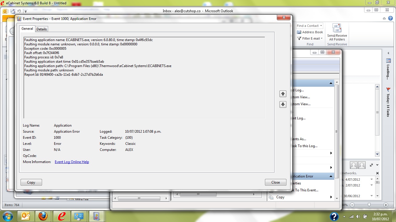

It crashed again today so attached is the event log. I was bringing a cabinet into line editor. My laptop is a HP pavilion I5 2nd generation 4 GB ram CPU 2.30 GHz that i bought about October last year so i would of thought it would be okay?
Will download Nvidas latest driver though.
Re: General bugs
Alex,
Your computer has integrated graphics which is probably the cause of your problems. There are minimum computer specifications listed on the eCabinets web site.

It could well be the integrated graphics that is causing some of your problems, but for what it's worth now seeing your cabinets, yeah I've had ecabs throw up some random issues when adding draw boxes that manage to shift up above the unit and does some really weird stuff, that when I try to replicate often doesn't happen again. Frustrating, yes.
With the units that you are doing i notice that you have one long unit and another one butting into it are you doing this for display purposes? Have you tried making both items separately in a batch, save them into a library, open a new job bring one item in and then adding the other item and butting it into it that way? Don't think I explained myself very well there, but I often do units more complex than that without issues -generally :)
