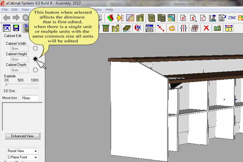

Re: Feature Requests
I would find this feature or variations on this feature very useful.
The way I see it working is when the button is selected, when you highlight a cabinet, (or could I slip in the word,cabinets ) you could straight away type in the size, without the need to click in the box,and it would affect those units.
A bit of a multi function button.
Anyone else think this would be worthwhile?
