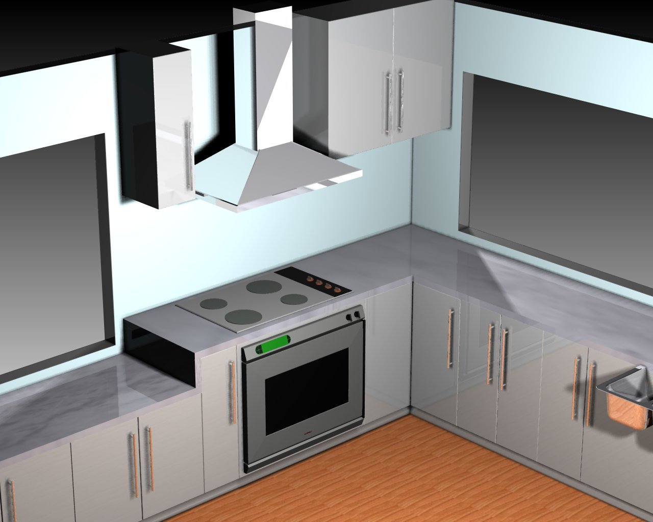

the countertop thickness is not displaying correctly. I have designed the countertop with a material thickness of 40mm but it displays as 20mm. if you hover over it shows as 40mm (counter pic) but still displays as 20mm (counter2 pic not the 40mm display cube). Is this a bug or am i doing something wrong?

I don't know if its possible ( ecabs takes me far too long to design a kitchen) but is the benchtop at the correct height? IE is the benchtop actually sitting 20mm inside the cabinet?

It has a 20mm overhang and its flush at the back so you would see the front edge as 40mm even if it was in the cab.

Have you tried in elevation view to move the CT up and see if it is the right thickness??Steven Daws wrote:It has a 20mm overhang and its flush at the back so you would see the front edge as 40mm even if it was in the cab.

Look at the new pic with one of the lower cabs deleted. Note the 40mm display cube for the stone return.Wally Schneeberger wrote:Have you tried in elevation view to move the CT up and see if it is the right thickness??Steven Daws wrote:It has a 20mm overhang and its flush at the back so you would see the front edge as 40mm even if it was in the cab.

It’s a work in progress, i didn’t relies the Benchtop wasn’t displaying correctly until i went to put the sink in.
