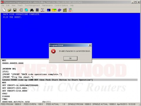

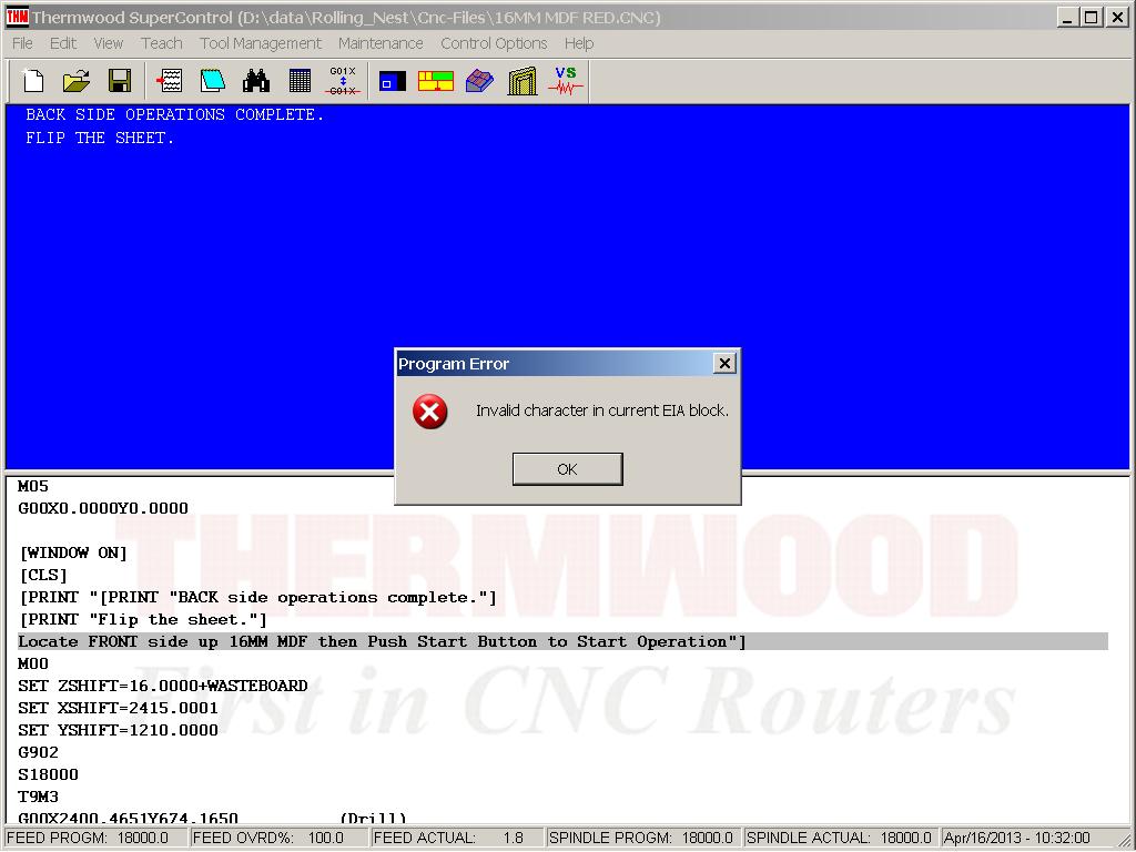

hello all
iam getting the following error at flip operations after updatingt the CN 5.73 to 5.74
is it some thing to do in settings or to do with post processor of the machine
(file extensions need to be corrected before attempting to open the file)
please advise us
thanks
Mohan
please advise us
thanks
Mohan

It looks like there should be [PRINT " at the beginning of your highlighted line.

As a matter of fact, the [PRINT " seems to have migrated two lines up... There seems to be an extra one there!

It is missing the bracket [ in front of the Locate. L is an invalid character.

P.S. Jeremey is correct. PRINT is the Advanced Function Language command and must be preceded by the square bracket [. The remainder is the text that will be shown on the screen, so it needs the quote symbol in front of the text string i.e., "Locate .......Dennis Englert wrote:It is missing the bracket [ in front of the Locate. L is an invalid character.

I have duplicated the error and have informed the software engineers of the issue. At this time, you can reinstall V5.73 and it will work correctly.
