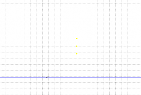

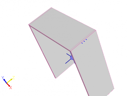

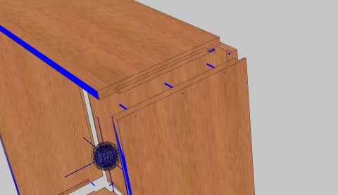

Maybe you could create an "rta" pattern that has a hole at 0,0 then add holes to left and right with 32mm spacing, then when you use the pattern, increase the value for what part size that will use a "single" hole. I think this is what you mean?
