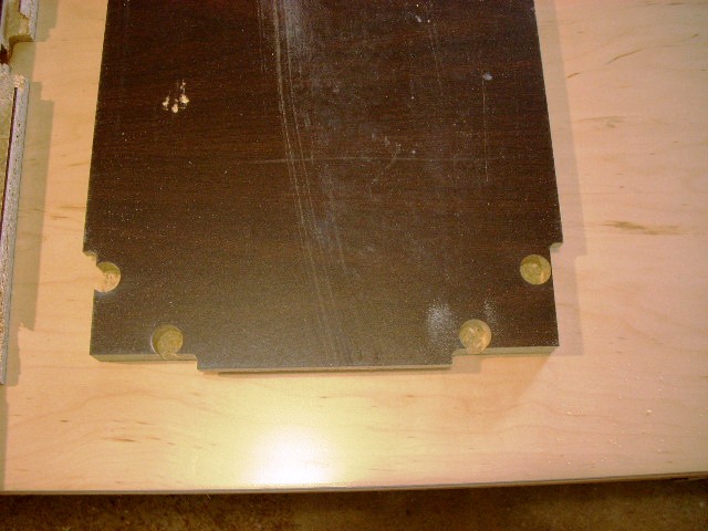

We successfully were cutting flip operations a couple days ago. Then have been running a series of jobs without flip ops. Now back to flip op job and the X axis is off and flip ops are coming out wrong. See pictures. Y axis appears to be correct. You can see the dado is too long on one side leaving an extra piece on flip side and they are too short on other side. Or you can see the KD holes don't line up and are whole circles on one side and too short on the other. Off by about .125 (guess, not measured).
We did have an X axis C-marker error in recent days and would that require us to have to reset all the G52 fixture offsets?? This is the only thing we can come up with that would explain this.

[attachment=0]Flip 1.jpg[/attachment

Problem resolved. Issue was ours, not Thermwood! Ever feel like choking your help??? Here is what I sent to Joe at Thermwood outlining the solution. One big lesson is to re-verify the G52 locations if you ever get a C marker error and have to reset the axis. I am convinced that is the start of this but it went on so long for our own stupidity!
I think problem is resolved. I write this with a lot of egg on face.(!) Based on the insistence that programs are correct, etc and had to be in the G52L1, last night I took my operator and physically watched him verify the coordinates of fixture offset. Turns out we found 3 things:
- Biggest problem was the operator was verifying the G52 location using a 3/8 tool and when doing the math was subtracting the tool radius of 0.249 creating the vast majority of the error.
- There was a small ding in actual fixture where it got dropped or something and while only a few thousandths, not helping.
- The C-marker error we had must require that we "re-verify" or recalibrate the G52 location. Supposedly we had done it multiple times but operator using wrong tool dimensions oddly matched the error we were seeing within reason. Any time we have a C-Marker error we are going to verify G52 presets in future.
We had to make a new G52 location and successfully made good parts.!@#$%^&*
