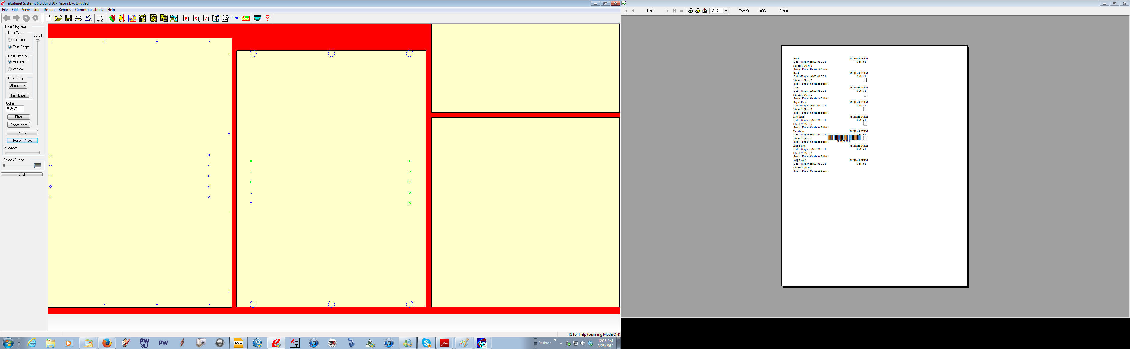

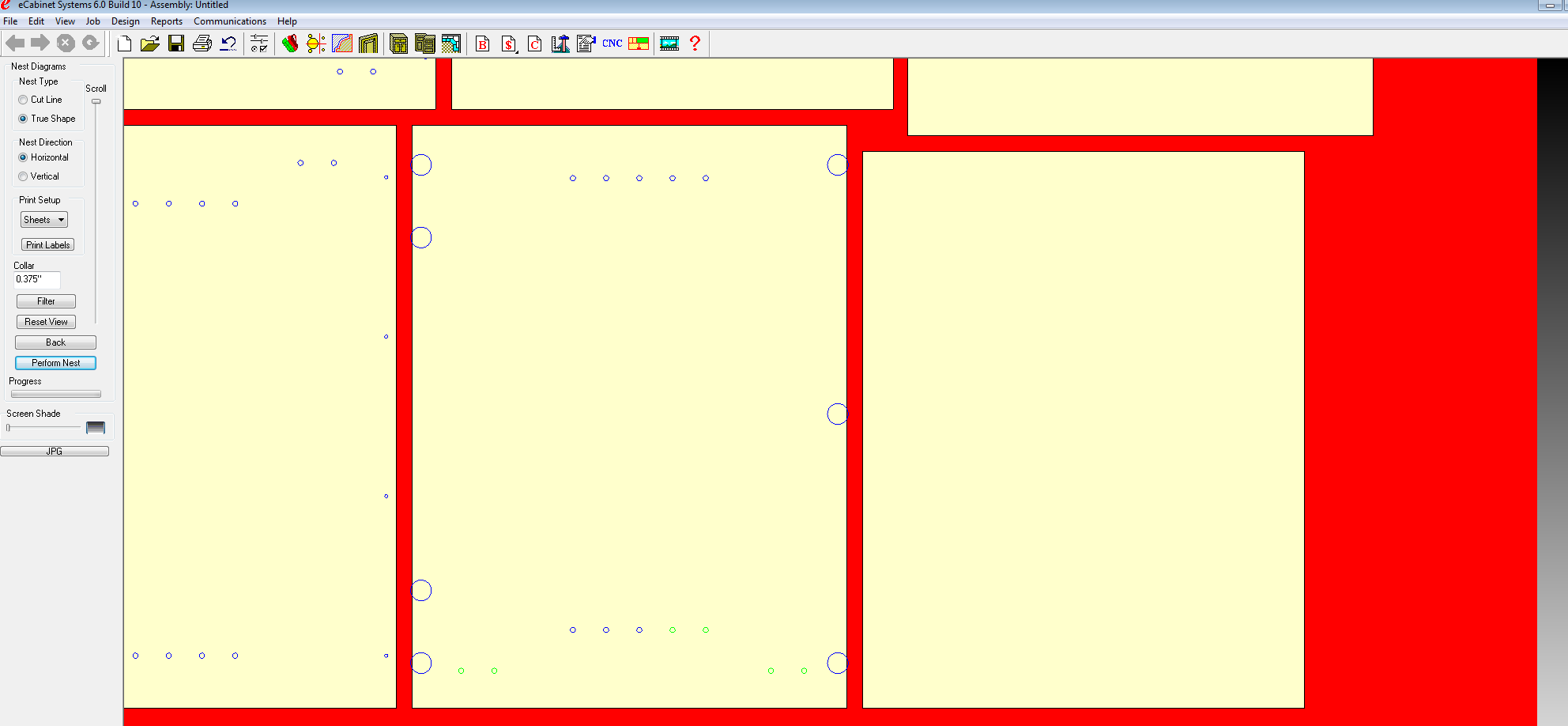

Oddly it is showing green holes in about half the shelf pin holes of one shelf! I have 4 partitions that are getting flip labels from the link and are nesting the holes this way. Just tried increasing depth of shelf pin holes to .378" in .76" material and nested the part. Picture shows the resulting nest. Very odd.
On second thought I may fiddle fart around some more with the cab. I only highlighted the shelf and changed the construction setting. Might need to strip the shelf out and re-install it with the revised shelf pin hole depths. It's never good to assume that what you did will get done in the program unless you strip it out and re-install or start all over. I'll check and see if this resolves it after I get a sheet going in a few minutes.

Post by Tim Massa »
Still Have it happening in E-cabs. Odd....

Post by Tim Massa »
Goes away in link.....
