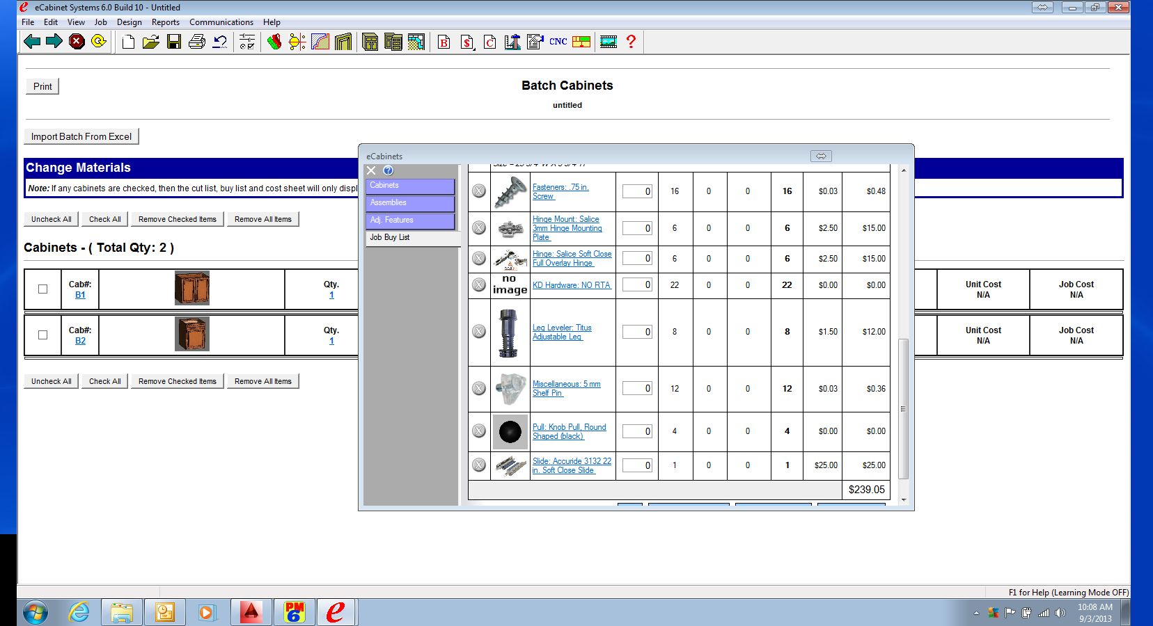

When I hit the 'Jobs Buy List' selection in the window menu it's a dead button, though the instruction say it is supposed to work. Attached images are what I'm getting from the jobs buy list and cabinet buy list showing the dead button compared to cabinet buy list.
Is there another dirt road to take to get a list similar to the one in the 'cabinets buy list' for the 'jobs buy list' that will have the pretty pictures and easy to read layout, as opposed to the old standard harder to read print out from the 'BUY LIST' icon in the main tool bar.

I use it all the time but it works as expected. Post the job you are working on.

That's frustratingly good news. Two other people can get it to work so must be something on my end. Here's an attached batch that was not working with the 'Job buy list'. Kerry, if you can get it to work I'm wondering if I need a repair of my current Ecabs build?

O.K., I tried adding leg levelers, sockets, etc.. to a seed cabinet thru the cabinet buy list. Used the 'Add Items to Assembly' button in the cabinet buy list and re-saved seed cabinet in my seed cab folder. Started new, reloaded seed cab and checked the cab buy list. None of the added bits of hardware were saved by this method. Just the pieces of hardware that got associated thru the KD/RTA applied hardware menu.
So is there no other means to add additional hardware to a seed cabinet, such as leg levelers for a base cab, pie cut turntable for a lazy susan corner base, if all you do is primarily batch out modified seed cabinets in E-cabs?
Is there a dirt road to take that can get me from here (having to remember to remember to add additional hardware pieces to the batch each time a seed cabinet is added) to there (having those additional hardware pieces added to a seed cabinet thereby lowering the amount of remembering to remember)?
For batching out jobs, having these additional bits and pieces of hardware pre-saved for the buy list would be an enormous help for myself and the people I'm cutting for. Just haven't figured out if or how it's possible. Can't find any posts yet searching the forum.

Make sure that you have the entire cabinet selected (Double Click on the cabinet) before adding new hardware.

Just tried it and worked like a charm. That is going to be a big help in setting up seed cabinets for others as well as myself.
