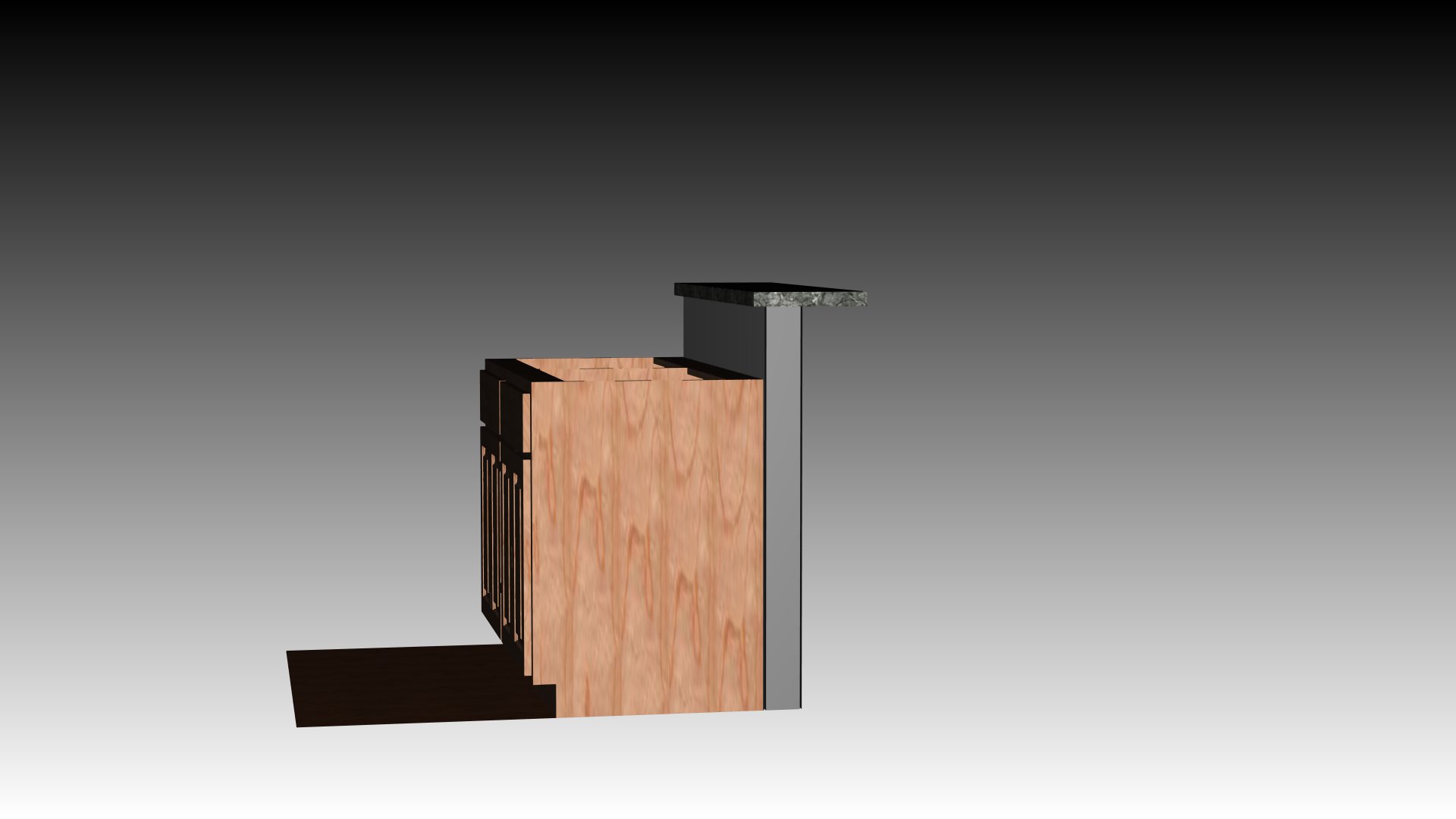

I would create a display cube for the counter top. It may be easier to do this in the cabinet editor. If you chose to do it in Cabinet editor make sure that you associate the display cube with the cabinet before returning to the layout.
As for the 22 1/2 deg. angles it would help if you posted the layout.
This was done using a display cube taking the cabinet from custom layout to cabinet editor and then associating it with the cabinet

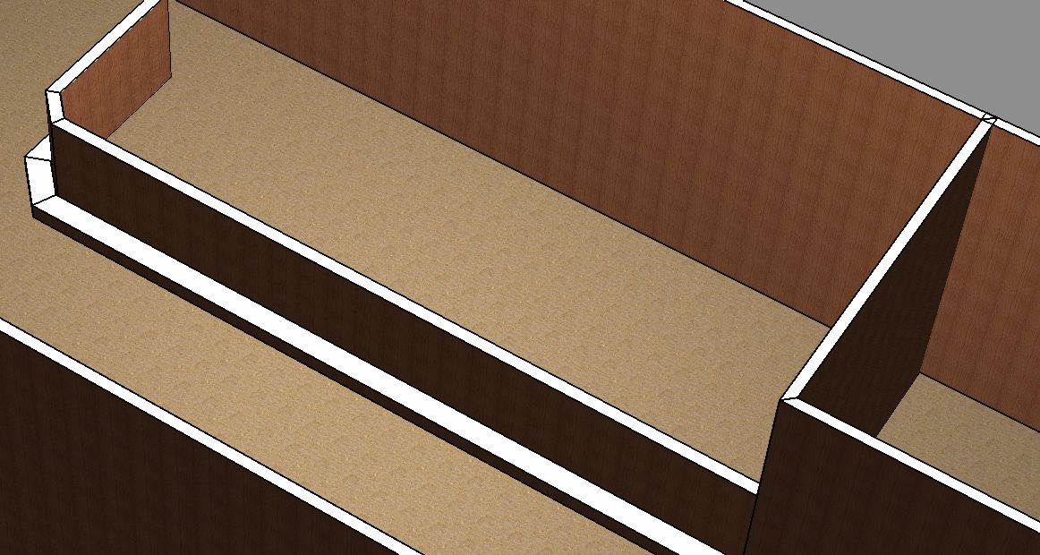

Thank you Scott. That worked great. I've attached an image of the bar and toe/foot rest that I created previously using the wall tools. If there is a way to "cut" the display cubes at an angle to create the corner/turn, I think I'll have what I'm looking for.
