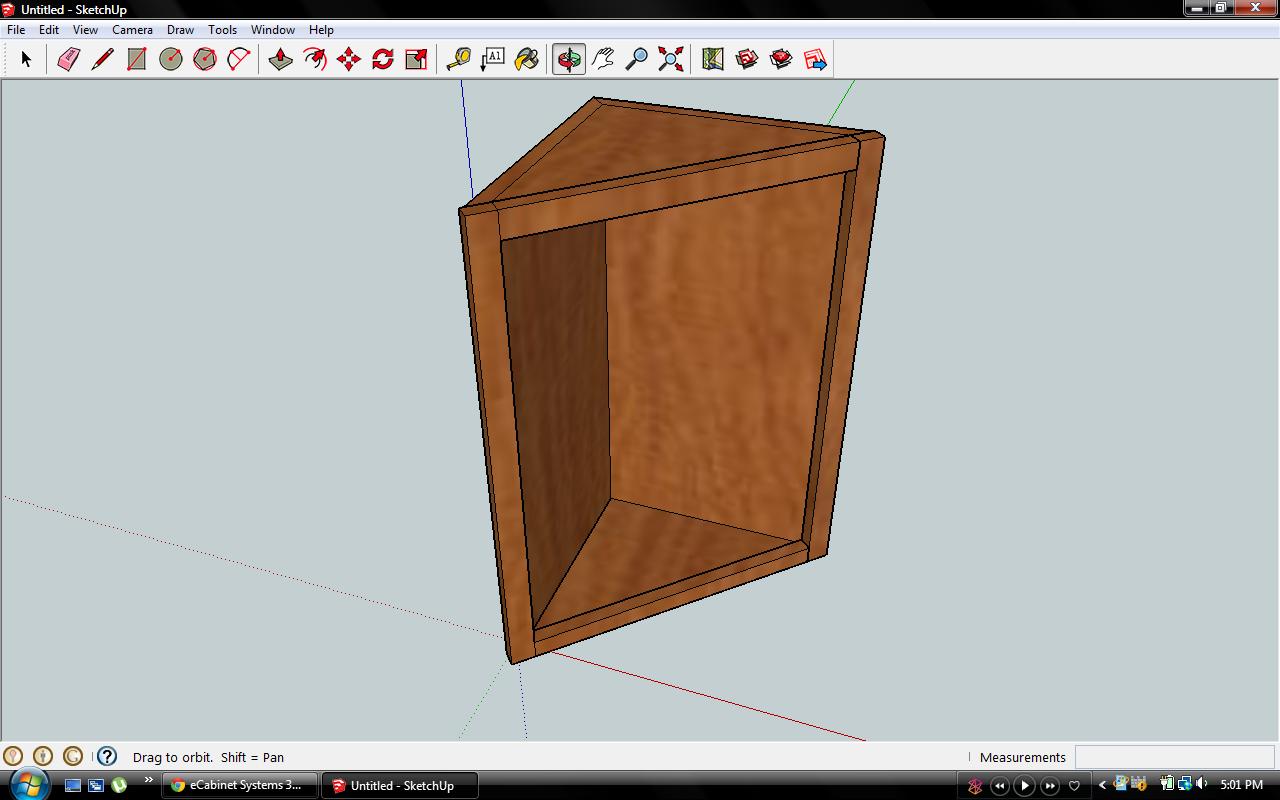

Hey Everyone,
I've been using ECabinets for just under a month now and have slowly been figuring the program out. I was using Google Sketchup before this and have been trying to recreate all of my original designs in ECabs. However, one thing I use A LOT is a like a 3 sided corner cabinet (left/ride side & angled front) and I have not been able to figure this out. I get turned around when trying adjust the dimensions for the corner cabinets. Ideally I'd like to have something that can be somewhat easily adjusted. I've attached a picture of what it is I'm trying to accomplish. Any and all help would be GREATLY appreciated (until I can figure this out I'm a bit of a standstill). Thank you all in advance.

The way that I make this type of upper cabinet is to use a standard upper cabinet with just the face frame, top and deck along with a Upper corner with the back only. Saved as an assembly
